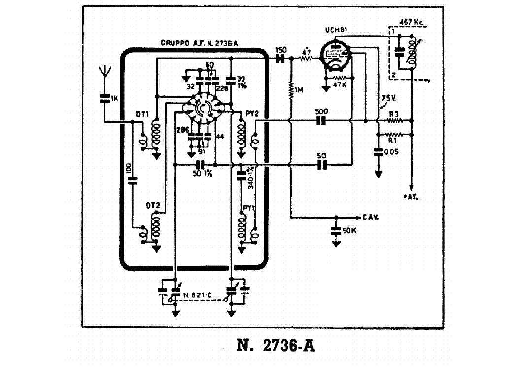

GELOSO SUPER G75R AM RADIO RECEIVER SCH
373.4 KB
Looking for similar geloso manual?
    GELOSO SUPER G-75R AM RADIO RECEIVER G75R 75
