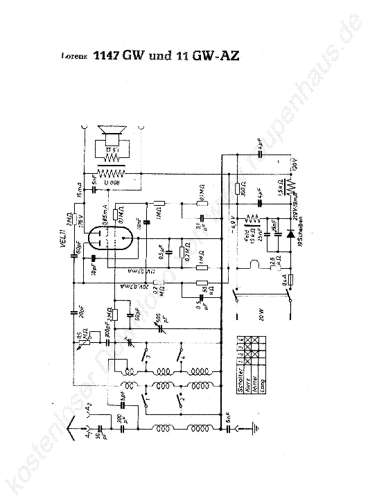

LORENZ ZWERGSUPER SUPER-1-4647GW 1947 SCH
Type: (PNG)
64.0 KB
    LORENZ ZWERGSUPER 1947 SUPER 14647 GW 4647GW
