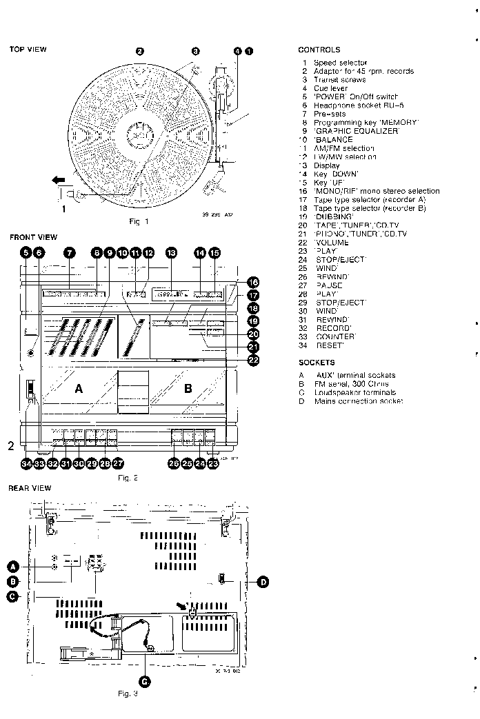

PHILIPS F1664 F1667
4.0 MB
37
PHILIPS F1664 F1667 service manual (1st page)
Preview of PHILIPS F1664 F1667 [1st page]
PHILIPS F1664 F1667 service manual (2nd page)
Preview of PHILIPS F1664 F1667 [2nd page]
    PHILIPS F-1664 F1664 F1667 1664 1667
