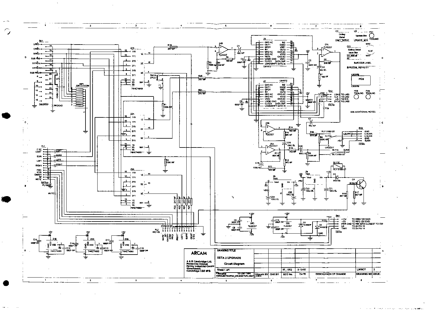

ARCAM ALPHA8 ALPHA8SE CD DAC PCB
166.4 KB
6
Looking for similar arcam manual?
ARCAM ALPHA8 ALPHA8SE CD DAC PCB service manual (1st page)
Preview of ARCAM ALPHA8 ALPHA8SE CD DAC PCB [1st page]
ARCAM ALPHA8 ALPHA8SE CD DAC PCB service manual (2nd page)
Preview of ARCAM ALPHA8 ALPHA8SE CD DAC PCB [2nd page]
    ARCAM ALPHA-8 CD DAC PCB ALPHA8 ALPHA8SE ALPHA SE
