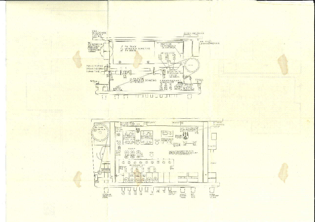

BANG-OLUFSEN BEOMASTER 900 ADJUSTMENTPOINT
AUDIO - INFO-TIPS
2.2 MB
INFO-TIPS
Looking for similar bang manual?
BANG-OLUFSEN BEOMASTER 900 ADJUSTMENTPOINT service manual (1st page)
Preview of BANG-OLUFSEN BEOMASTER 900 ADJUSTMENTPOINT [1st page]
    BEOMASTER 900 BANG OLUFSEN
