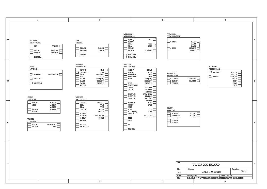

CHANGHONG H29D80 CHASSIS CH-10DR SCH
1.1 MB
Looking for similar changhong manual?
    CHANGHONG H-29D-80 CH-10DR H29D80 CHASSIS CH10DR 29 80 CH 10 DR 10DR
