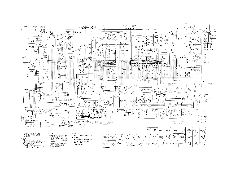

CHINA TCL-2528S,2938S SCH
Type: (JPG)
962.5 KB
Looking for similar china manual?
    CHINA TCL-2528S TCL2528S 2938S TCL 2528 2938 2528S
