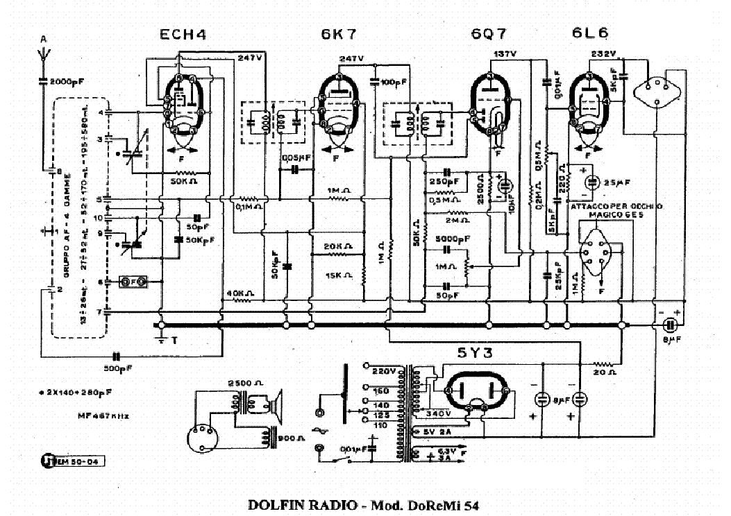

DOLFIN DOREMI 54 AM RADIO RECEIVER SCH
46.3 KB
Looking for similar dolfin manual?
DOLFIN DOREMI 54 AM RADIO RECEIVER SCH service manual (1st page)
Preview of DOLFIN DOREMI 54 AM RADIO RECEIVER SCH [1st page]
    DOLFIN DOREMI RADIO RECEIVER 54 AM
