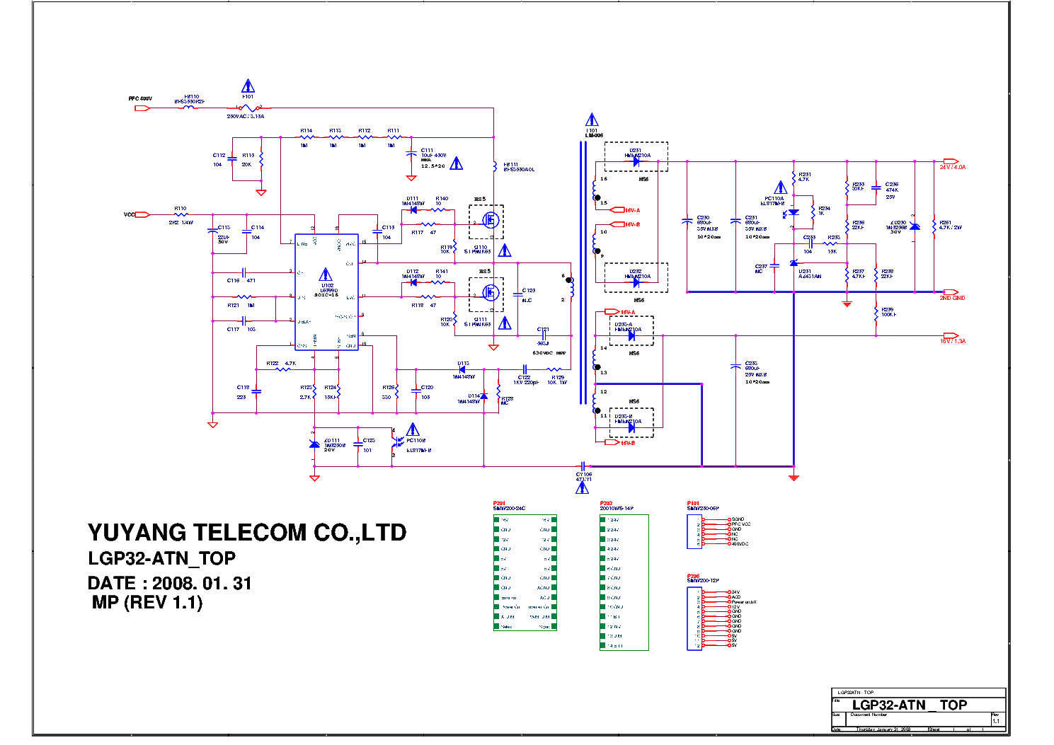

LG 32LV3100 TA POWER SUPPLY SCH
POWER-SUPPLY - SERVICE MANUAL
503.7 KB
POWER-SUPPLY
    LG POWER SUPPLY 32LV3100 TA 32 LV 3100
