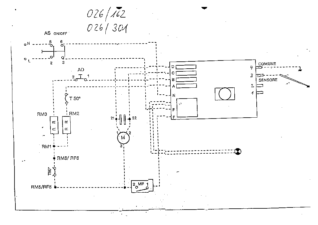

Sèche-linge BRANDT ETE6716F guide réparation
Hello
Here is the diagram of the Tumble Dryer BRANDT ETE6716F
good repair
