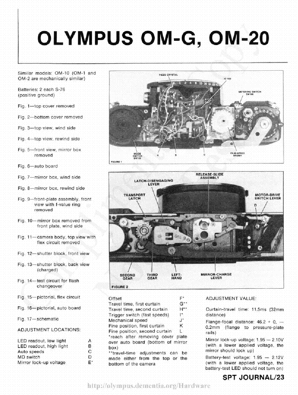

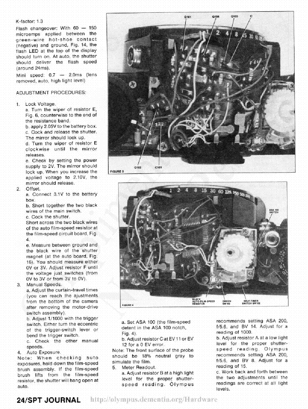

OLYMPUS OM-G OM-20
STILL CAMERA - SERVICE MANUAL
1.9 MB
10
STILL CAMERA
Looking for similar olympus manual?
OLYMPUS OM-G OM-20 service manual (1st page)
Preview of OLYMPUS OM-G OM-20 [1st page]
OLYMPUS OM-G OM-20 service manual (2nd page)
Preview of OLYMPUS OM-G OM-20 [2nd page]
    OLYMPUS OMG OM-20 OM20 OM 20 OM-G
