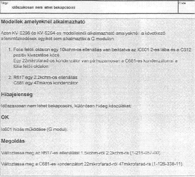

SONY SERVICE-INFO KV-S294 KV-E296 service manual (1st page)
Preview of SONY SERVICE-INFO KV-S294 KV-E296 [1st page]
    SONY KVS-294 KVS294 KVE296 KVS 294 KVE 296 INFO KV S294 E296 KV-S294 KV-E296
