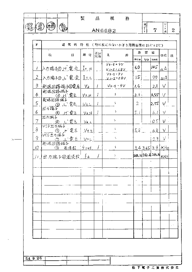

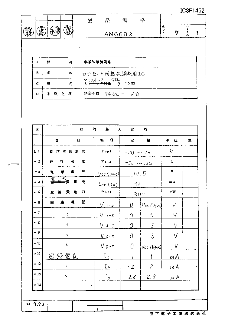

AN6682 IC TECHNICS SL-1200 SL-1210 MK2 DATAHEET
DATASHEET - OTHER
292.5 KB
DATASHEET
Looking for similar an manual?
AN6682 IC TECHNICS SL-1200 SL-1210 MK2 DATAHEET service manual (1st page)
Preview of AN6682 IC TECHNICS SL-1200 SL-1210 MK2 DATAHEET [1st page]
AN6682 IC TECHNICS SL-1200 SL-1210 MK2 DATAHEET service manual (2nd page)
Preview of AN6682 IC TECHNICS SL-1200 SL-1210 MK2 DATAHEET [2nd page]
    AN-6682 TECHNICS SL-1200 AN6682 IC SL1200 SL1210 MK2 DATAHEET AN 6682 SL 1200 1210 MK SL-1210
