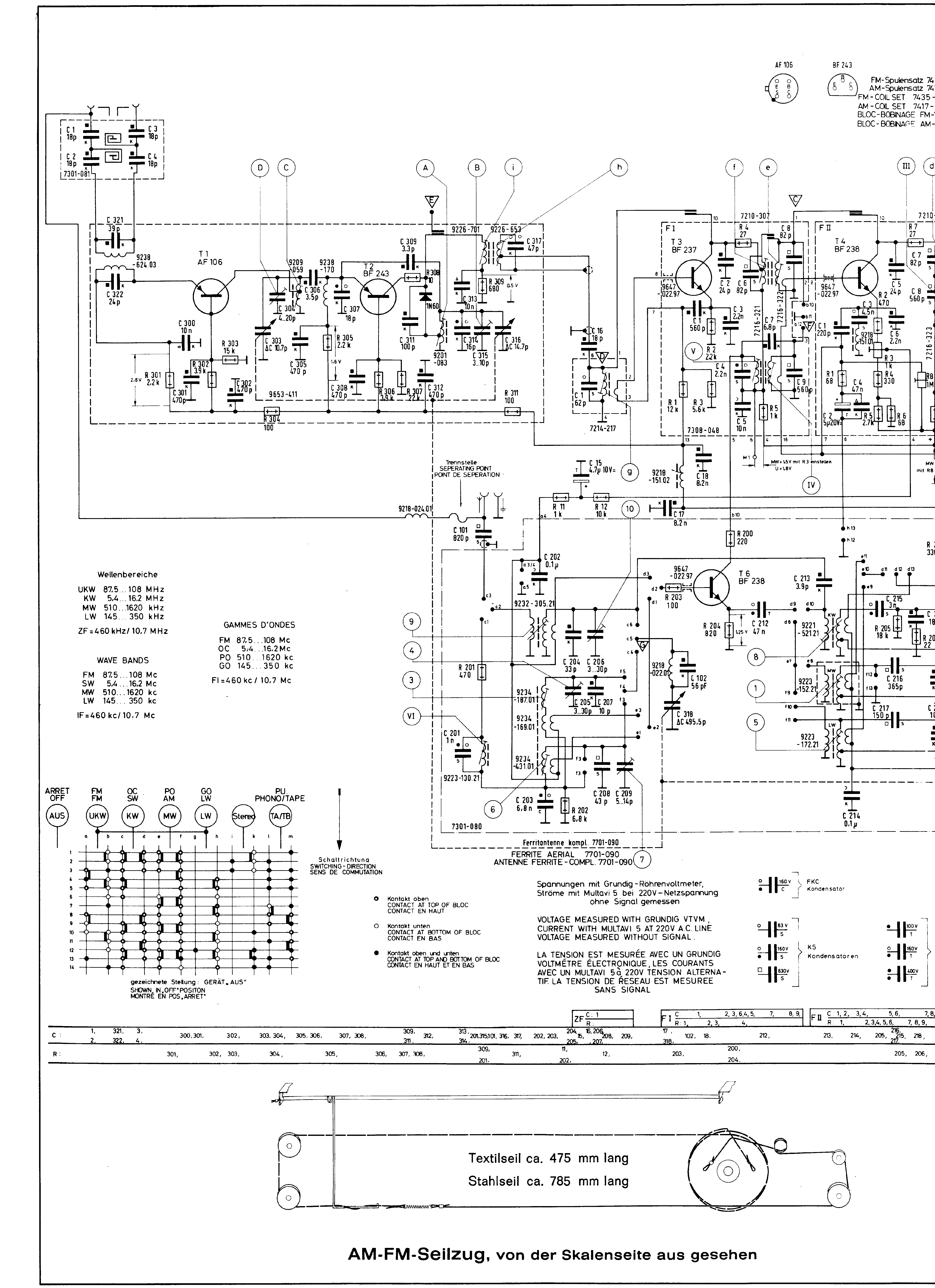

GRUNDIG V2 V2GB
13.6 MB
20
GRUNDIG V2 V2GB service manual (1st page)
Preview of GRUNDIG V2 V2GB [1st page]
GRUNDIG V2 V2GB service manual (2nd page)
Preview of GRUNDIG V2 V2GB [2nd page]
    GRUNDIG V-2 V2 V2GB GB
