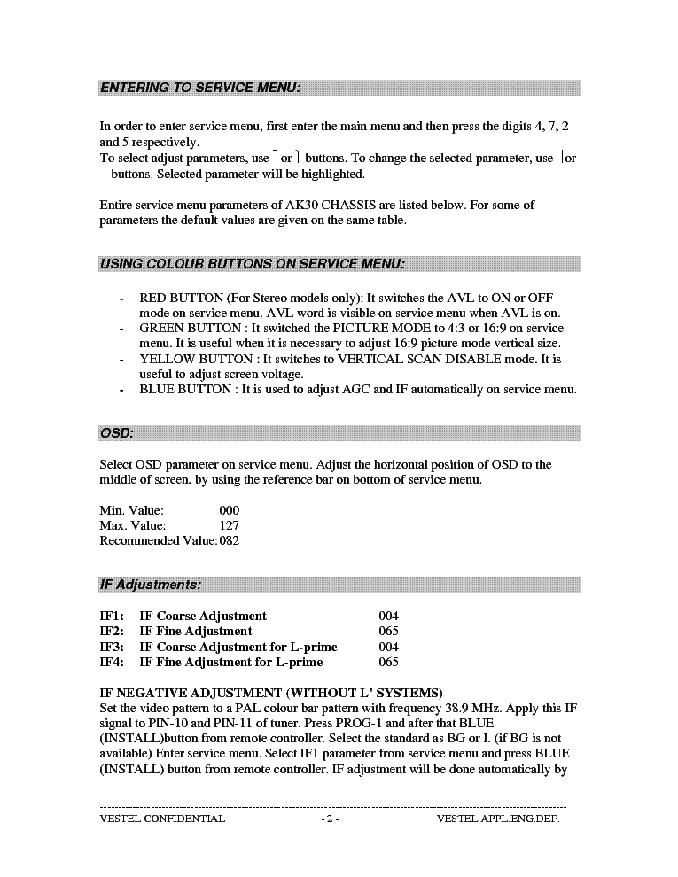

JVC 11AK30-J SERVICE INFO
TV - INFO-TIPS
385.4 KB
15
INFO-TIPS
JVC 11AK30-J SERVICE INFO service manual (1st page)
Preview of JVC 11AK30-J SERVICE INFO [1st page]
JVC 11AK30-J SERVICE INFO service manual (2nd page)
Preview of JVC 11AK30-J SERVICE INFO [2nd page]
    JVC INFO 11AK30J 11 AK 30 11AK30 11AK30-J
