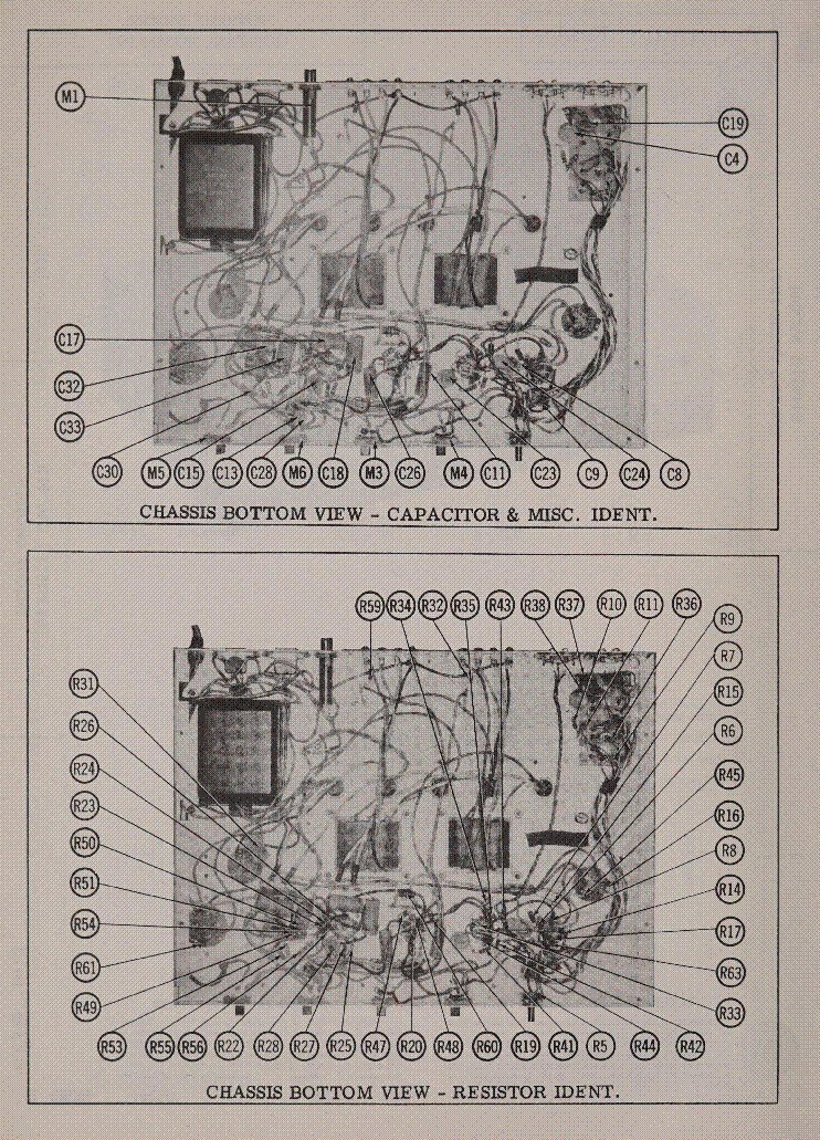

KNIGHT MODEL KN-740 92SU429 SM
5.6 MB
5
KNIGHT MODEL KN-740 92SU429 SM service manual (1st page)
Preview of KNIGHT MODEL KN-740 92SU429 SM [1st page]
KNIGHT MODEL KN-740 92SU429 SM service manual (2nd page)
Preview of KNIGHT MODEL KN-740 92SU429 SM [2nd page]
    KNIGHT MODEL KN-740 KN740 92SU429 KN 740 92 SU 429
