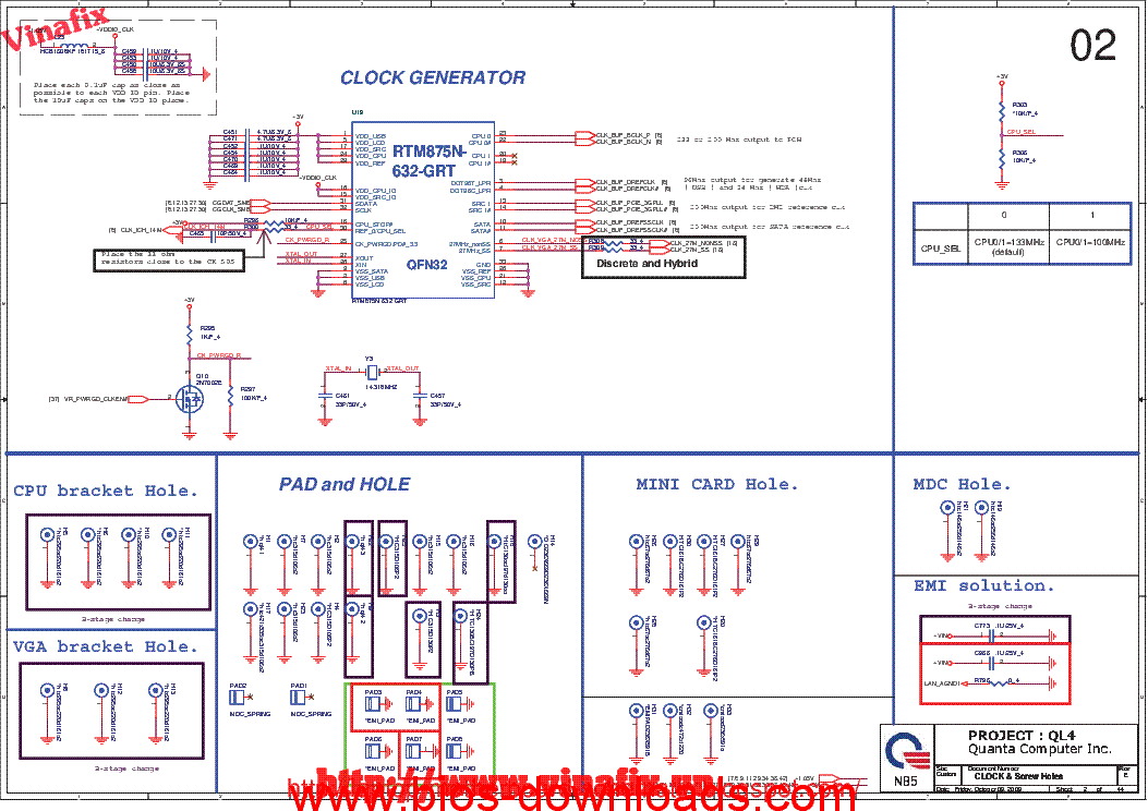

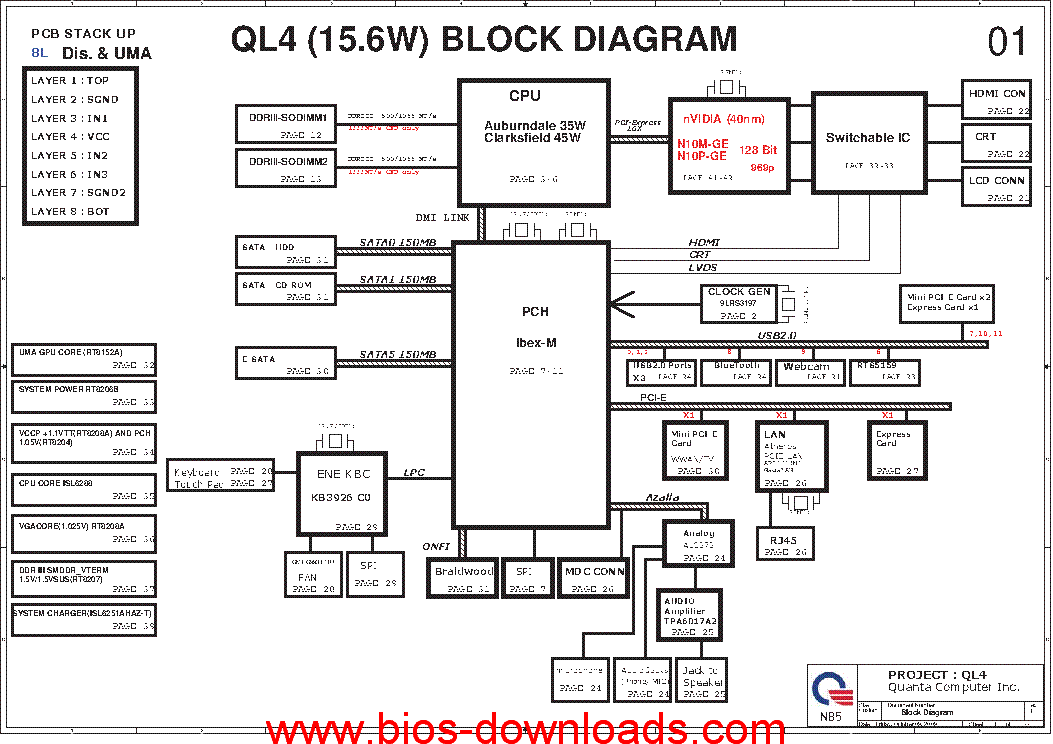

LG A550 QUANTA QL4 DAOQL4MB8EO SCH
NOTEBOOK-PC - SERVICE MANUAL
1.5 MB
44
NOTEBOOK-PC
LG A550 QUANTA QL4 DAOQL4MB8EO SCH service manual (1st page)
Preview of LG A550 QUANTA QL4 DAOQL4MB8EO SCH [1st page]
LG A550 QUANTA QL4 DAOQL4MB8EO SCH service manual (2nd page)
Preview of LG A550 QUANTA QL4 DAOQL4MB8EO SCH [2nd page]
    LG A-550 QL-4 A550 QUANTA QL4 550 QL DAOQL MB EO
