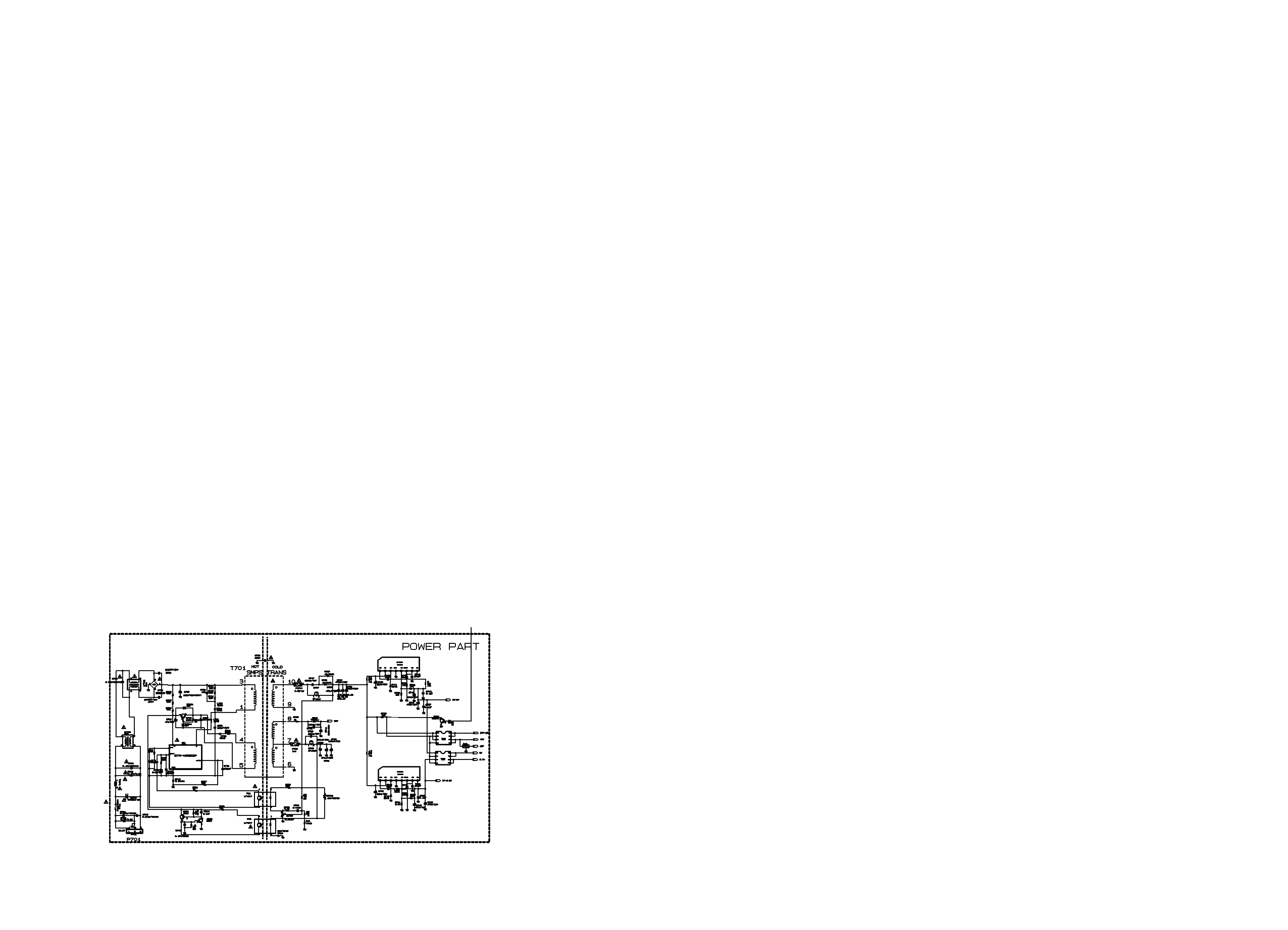

LG LHD457 PSU SCH
POWER-SUPPLY - SERVICE MANUAL
160.4 KB
POWER-SUPPLY
LG LHD457 PSU SCH service manual (1st page)
Preview of LG LHD457 PSU SCH [1st page]
    LG LHD-457 LHD457 PSU LHD 457
