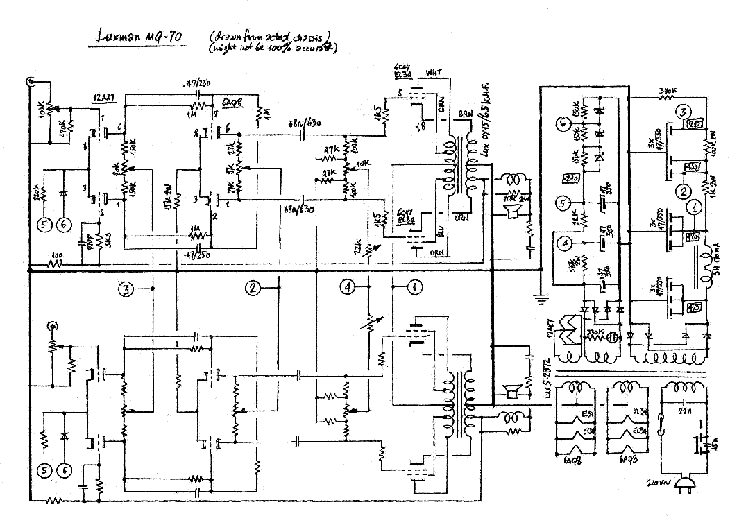

LUXMAN MQ-70 TUBE AMP SCHEMATIC
451.6 KB
Looking for similar luxman manual?
LUXMAN MQ-70 TUBE AMP SCHEMATIC service manual (1st page)
Preview of LUXMAN MQ-70 TUBE AMP SCHEMATIC [1st page]
    LUXMAN MQ-70 AMP SCHEMATIC MQ70 TUBE MQ 70
