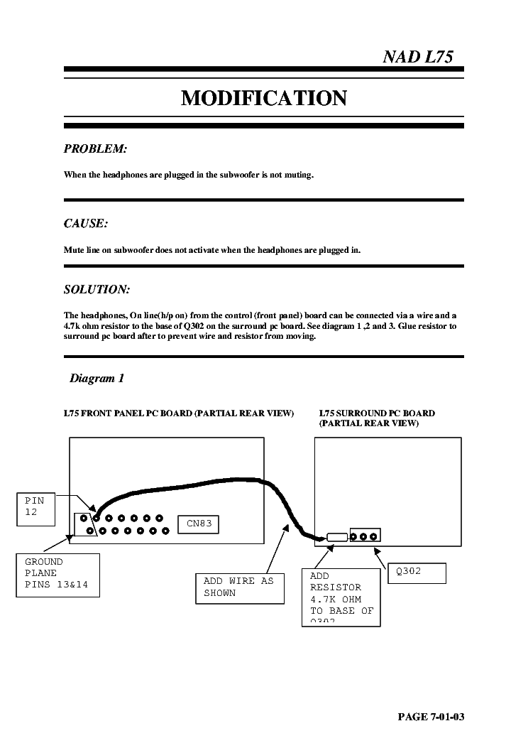

NAD L75 MODIFICATION PAGE 7-01-03

    NAD L-75 PAGE L75 70103 75 01 03 7-01-03
