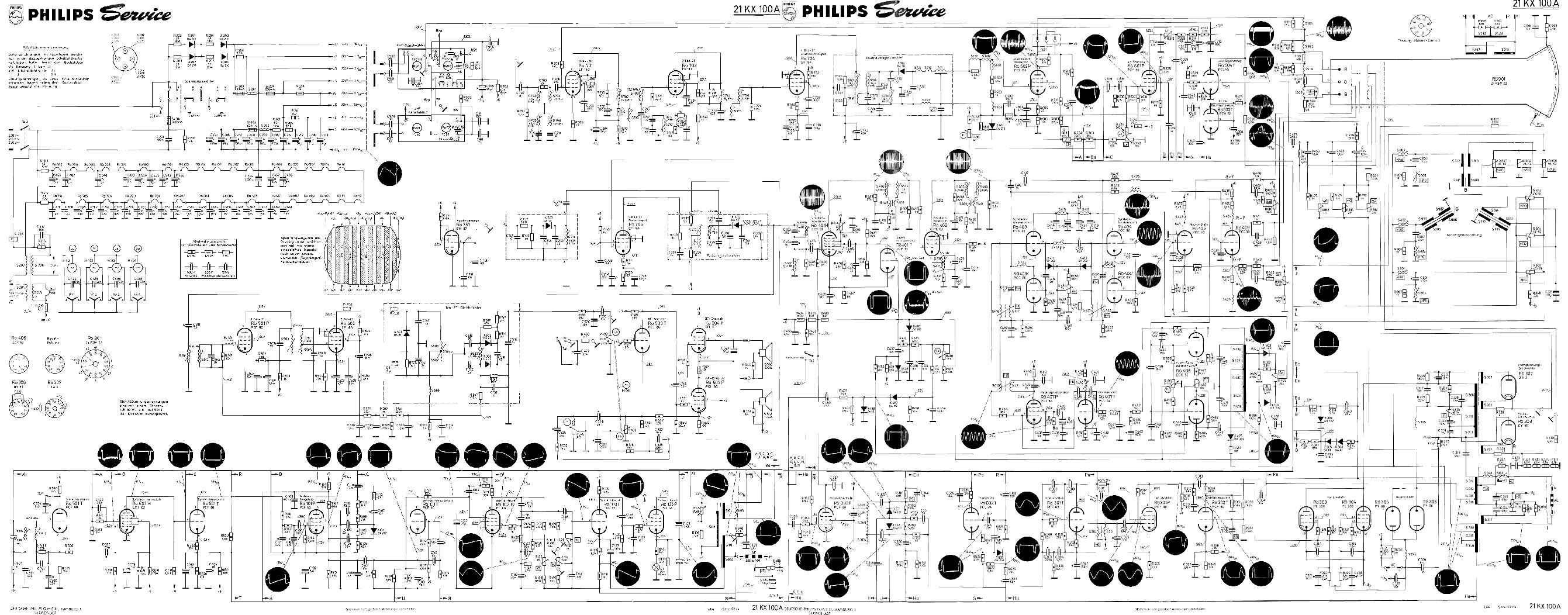

PHILIPS 21KX100A CRT TV SCH
1.2 MB
PHILIPS 21KX100A CRT TV SCH service manual (1st page)
Preview of PHILIPS 21KX100A CRT TV SCH [1st page]
    PHILIPS CRT TV 21KX100A 21 KX 100
