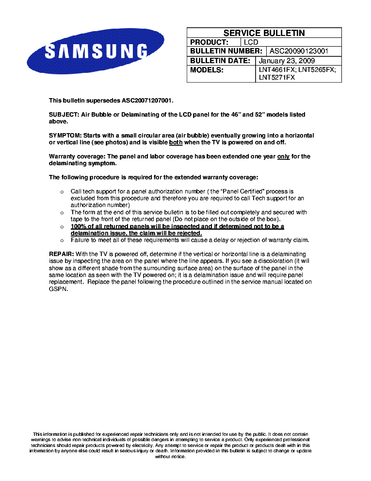

SAMSUNG ASC20090123001 LNT4661FX LNT5265FX LNT5271FX BULLETIN

SAMSUNG ASC20090123001 LNT4661FX LNT5265FX LNT5271FX BULLETIN service manual (1st page)
Preview of SAMSUNG ASC20090123001 LNT4661FX LNT5265FX LNT5271FX BULLETIN [1st page]
SAMSUNG ASC20090123001 LNT4661FX LNT5265FX LNT5271FX BULLETIN service manual (2nd page)
Preview of SAMSUNG ASC20090123001 LNT4661FX LNT5265FX LNT5271FX BULLETIN [2nd page]
    SAMSUNG LNT-5265FX LNT-5271FX LNT4661FX LNT5265FX LNT5271FX ASC LNT 4661 FX 5265 5271
