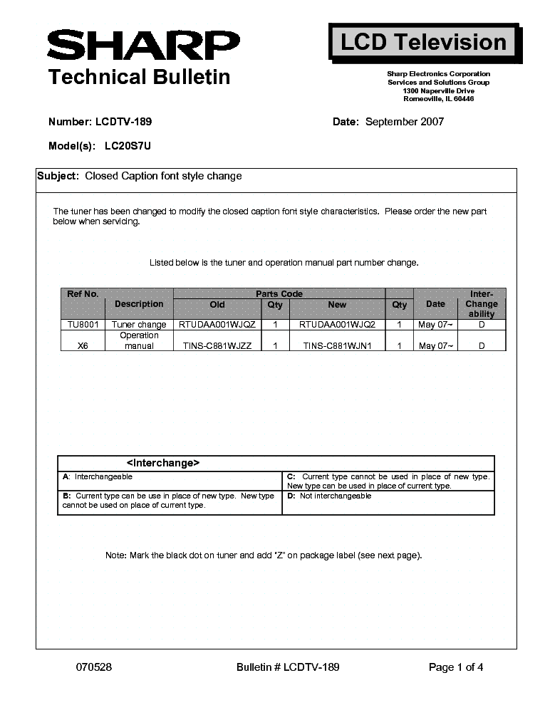

SHARP LCDTV-189 LC20S7U TECH BULLETIN
TV - INFO-TIPS
238.4 KB
5
INFO-TIPS
SHARP LCDTV-189 LC20S7U TECH BULLETIN service manual (1st page)
Preview of SHARP LCDTV-189 LC20S7U TECH BULLETIN [1st page]
SHARP LCDTV-189 LC20S7U TECH BULLETIN service manual (2nd page)
Preview of SHARP LCDTV-189 LC20S7U TECH BULLETIN [2nd page]
    SHARP LCDTV-189 TECH LCDTV189 LC20S7U LCDTV 189 LC 20
