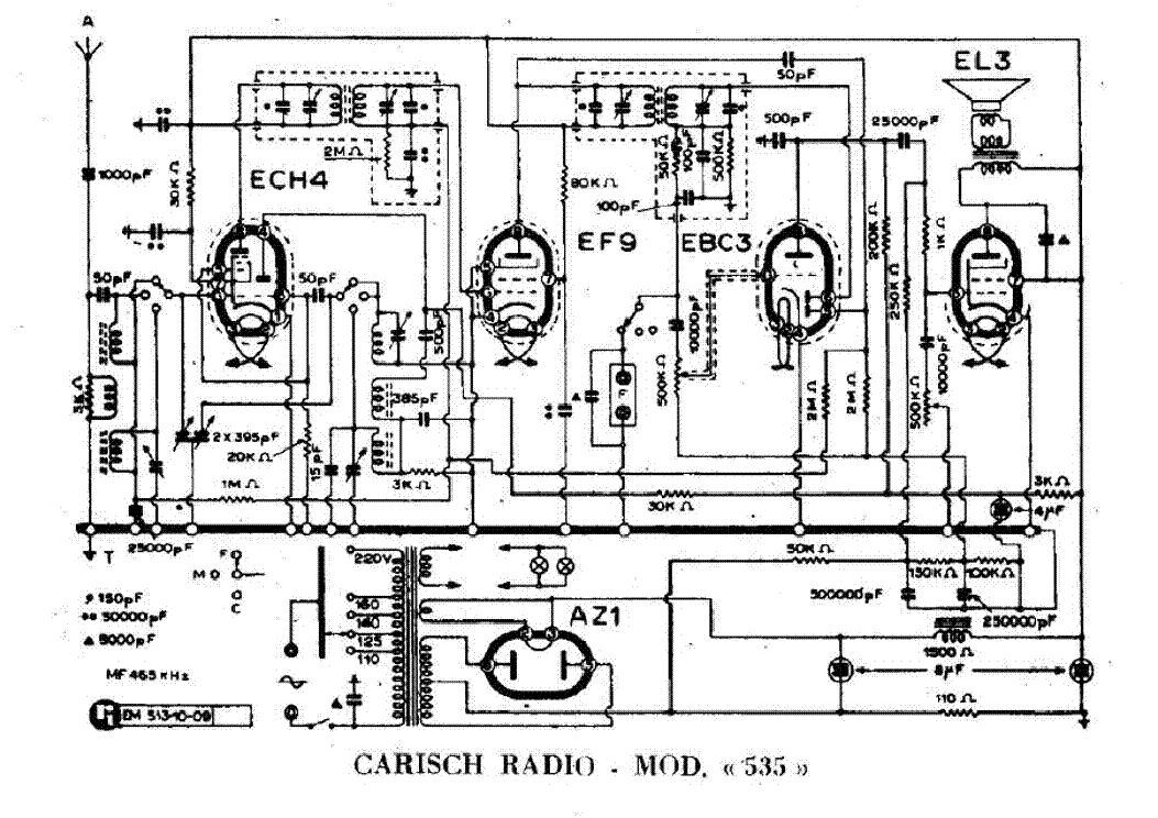

CARISCH 535 AM RADIO RECEIVER SCH
107.2 KB
Looking for similar carisch manual?
CARISCH 535 AM RADIO RECEIVER SCH service manual (1st page)
Preview of CARISCH 535 AM RADIO RECEIVER SCH [1st page]
    CARISCH RADIO RECEIVER 535 AM
