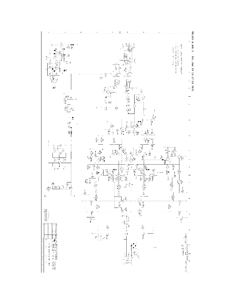

HAFLER P4000 SCH.
104.4 KB
Looking for similar hafler manual?
    HAFLER P-4000 P4000 SCH. 4000
