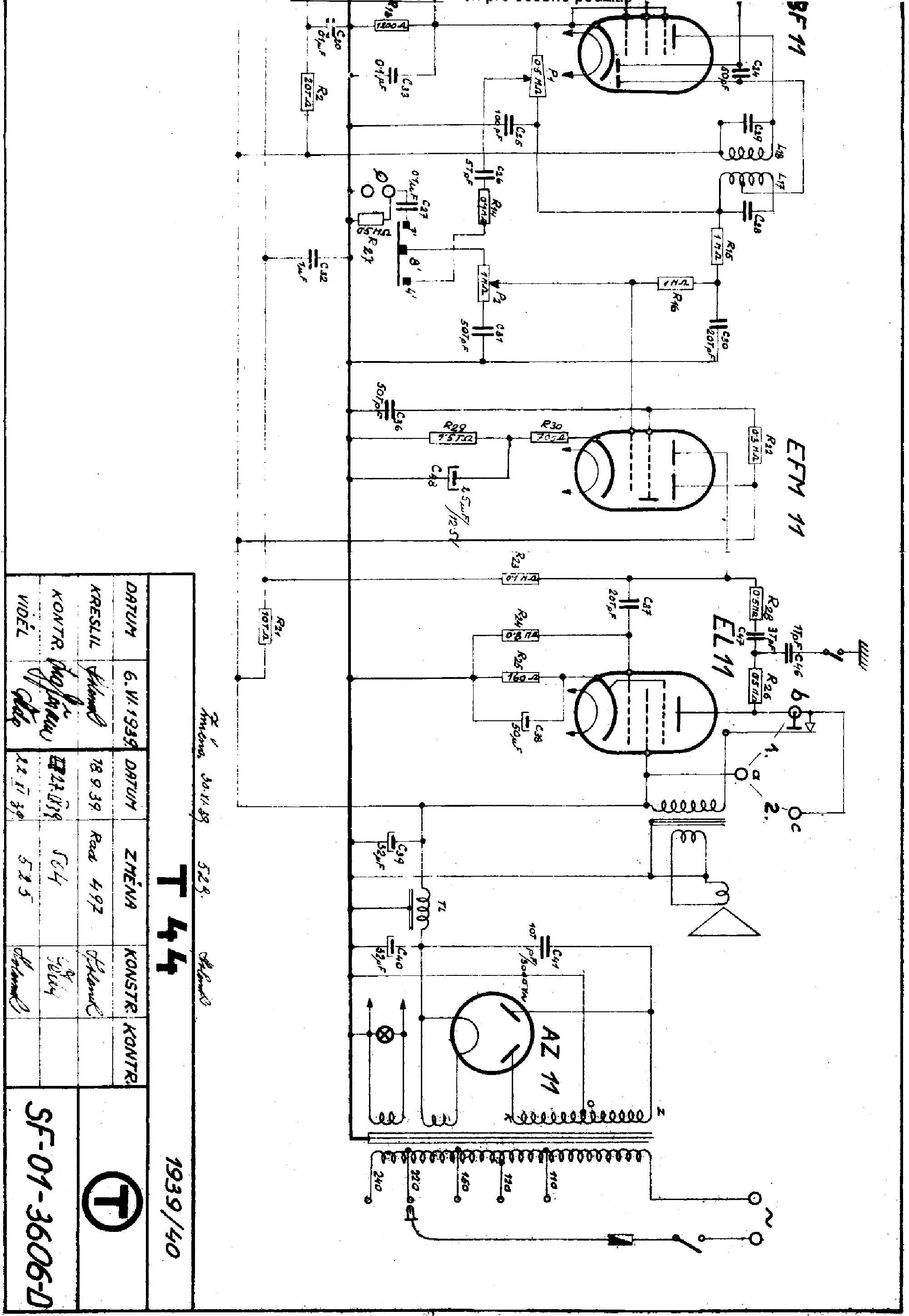

TELEGRAFIA T44 RADIO 1939 SCH
158.6 KB
Looking for similar telegrafia manual?
TELEGRAFIA T44 RADIO 1939 SCH service manual (1st page)
Preview of TELEGRAFIA T44 RADIO 1939 SCH [1st page]
TELEGRAFIA T44 RADIO 1939 SCH service manual (2nd page)
Preview of TELEGRAFIA T44 RADIO 1939 SCH [2nd page]
    TELEGRAFIA T-44 T44 RADIO 1939 44
