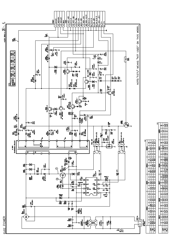

TOSHIBA 27WL46 POWER-SUPPLY SCH
POWER-SUPPLY - SERVICE MANUAL
Type: (JPG)
107.9 KB
POWER-SUPPLY
    TOSHIBA 27WL46 27 WL 46 POWER SUPPLY
