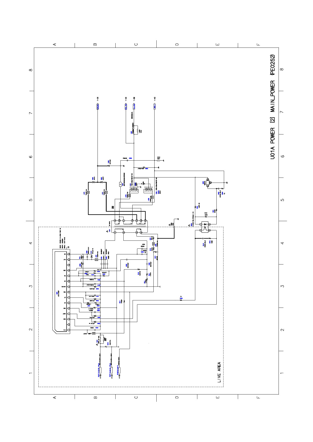

TOSHIBA PE0252 0253 V28A00032701 PSU SCH
POWER-SUPPLY - SERVICE MANUAL
566.6 KB
9
POWER-SUPPLY
TOSHIBA PE0252 0253 V28A00032701 PSU SCH service manual (1st page)
Preview of TOSHIBA PE0252 0253 V28A00032701 PSU SCH [1st page]
TOSHIBA PE0252 0253 V28A00032701 PSU SCH service manual (2nd page)
Preview of TOSHIBA PE0252 0253 V28A00032701 PSU SCH [2nd page]
    TOSHIBA PE-0252 PE0252 0253 PSU PE 0252 28 00032701
