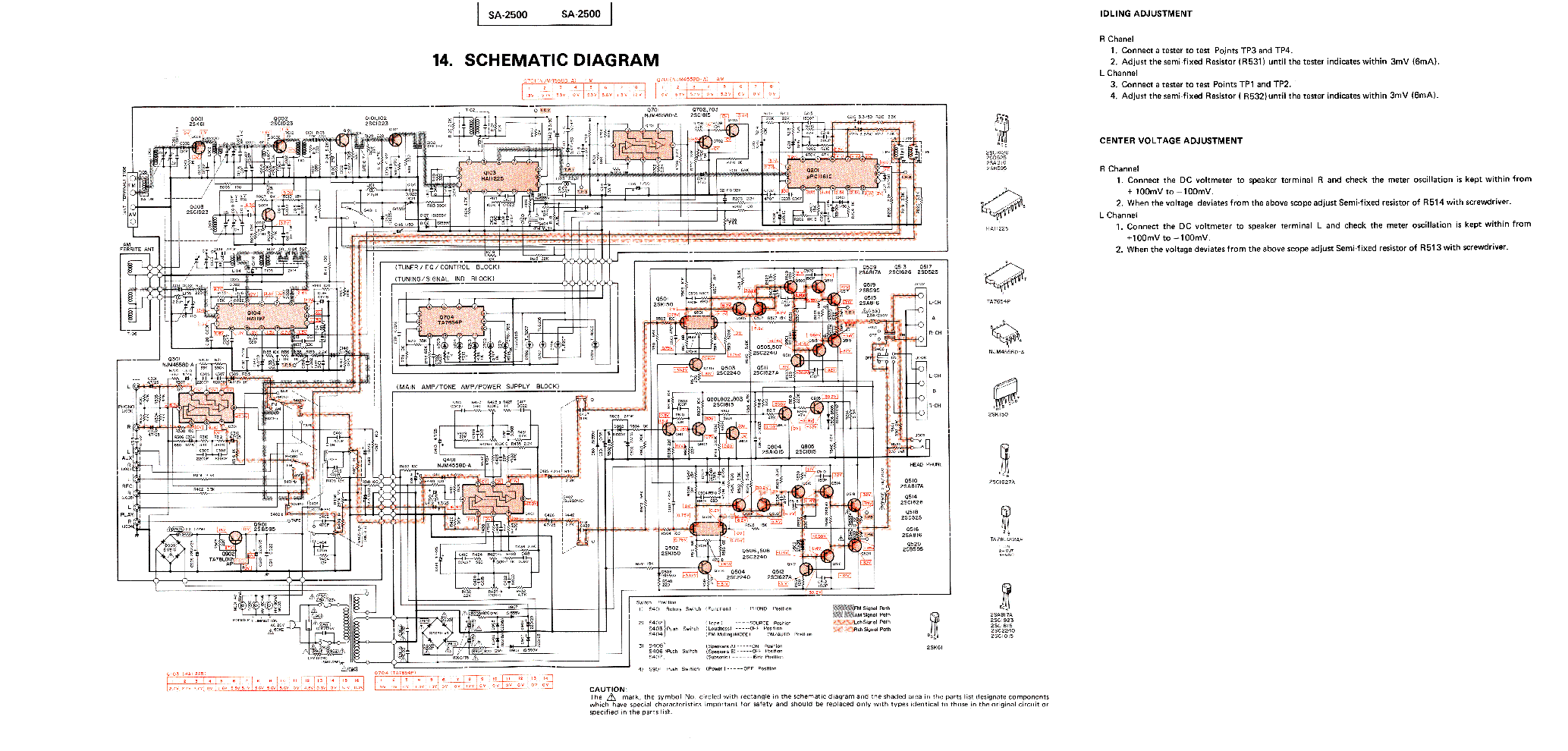

TOSHIBA SA-2500 SCHEMATIC
9.5 MB
TOSHIBA SA-2500 SCHEMATIC service manual (1st page)
Preview of TOSHIBA SA-2500 SCHEMATIC [1st page]
    TOSHIBA SA-2500 SA2500 SCHEMATIC SA 2500
