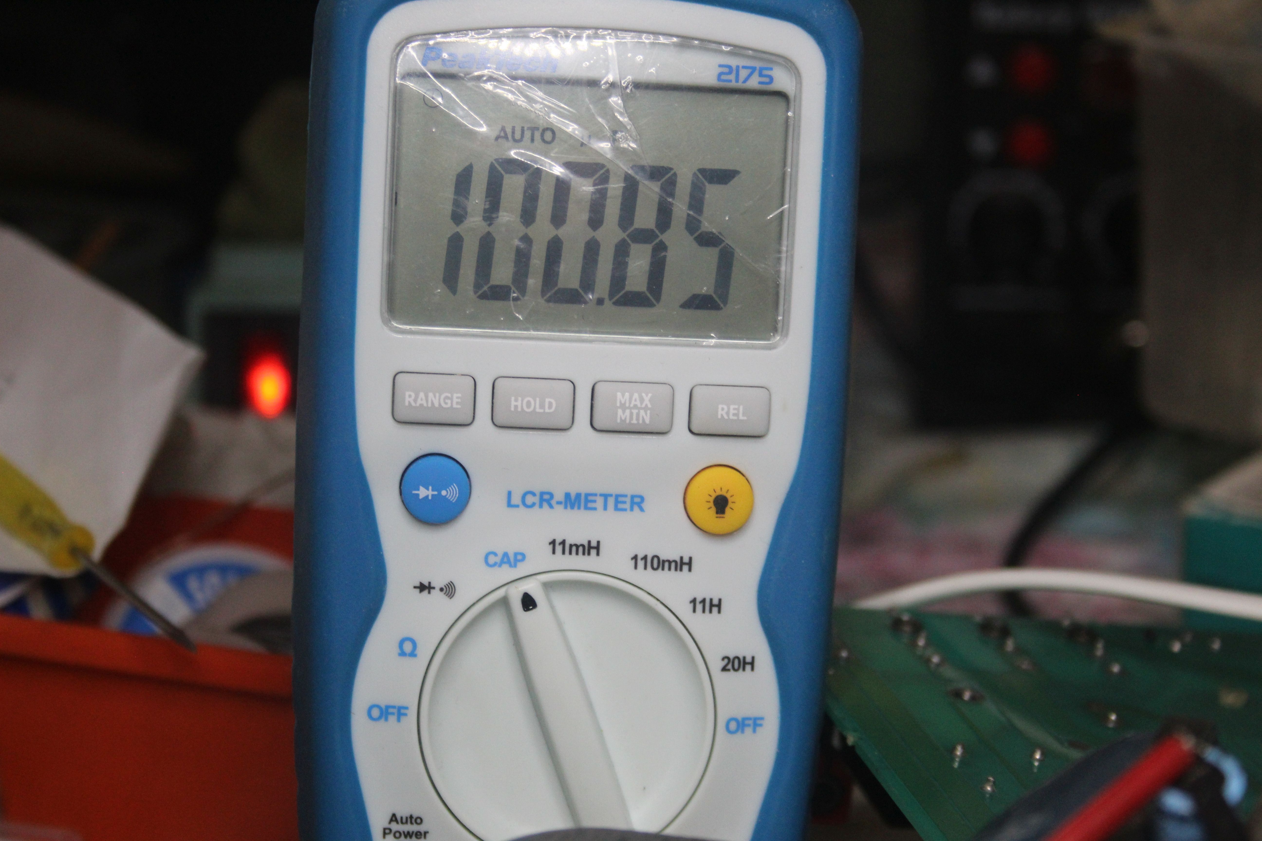

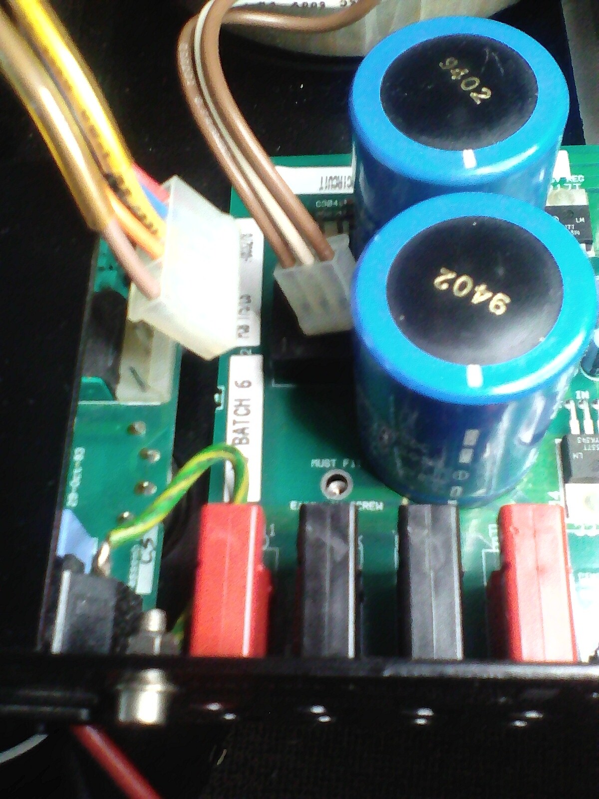

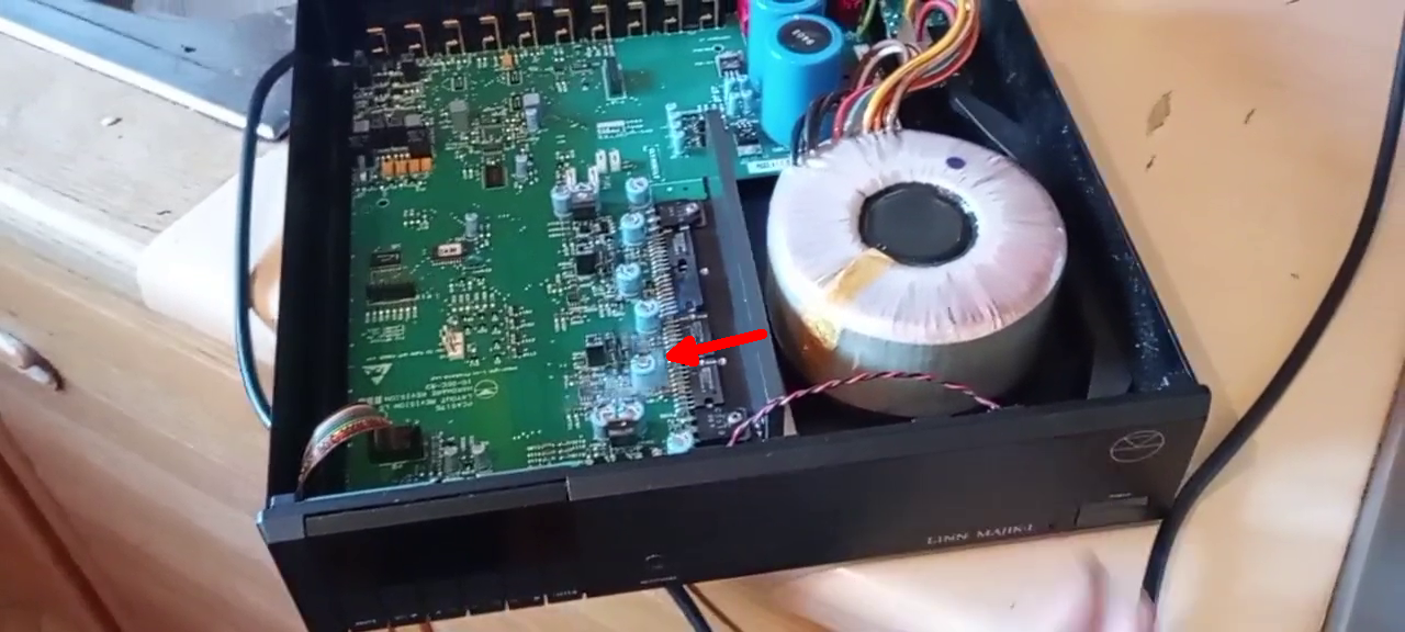

The IC was replaced and the circuit board provisionally reinstalled in the housing with all connections. A video was shot when switching on, from which the picture with the smoking electrolytic capacitor was taken. It is C702 (C2 in the circuit diagram in the square). It still seems to be OK in terms of capacitance, but it may no longer be able to withstand higher voltages.
This electrolytic capacitor was replaced.  If you now measure the resistance at the mains socket (all plugs inserted), it is infinite when switched off and when switched on the resistance is 5.3 ohms. According to I=U/R, this would mean that a current of >40 A would flow. Not even a house fuse can withstand that. On the small power supply board (which unfortunately does not appear in the circuit diagram), you can only see a capacitor (C1), the voltage selector switch on the back, as well as the mains switch and the 7-pin socket. There does not appear to be an NTC for limiting the inrush current.
 I will now just disconnect the 3-pin plug, the fuse has been replaced and then try to measure the secondary voltages on the toroidal transformer.

defekter C702
Wert C702
Netzteilplatine LINN MAJIK I

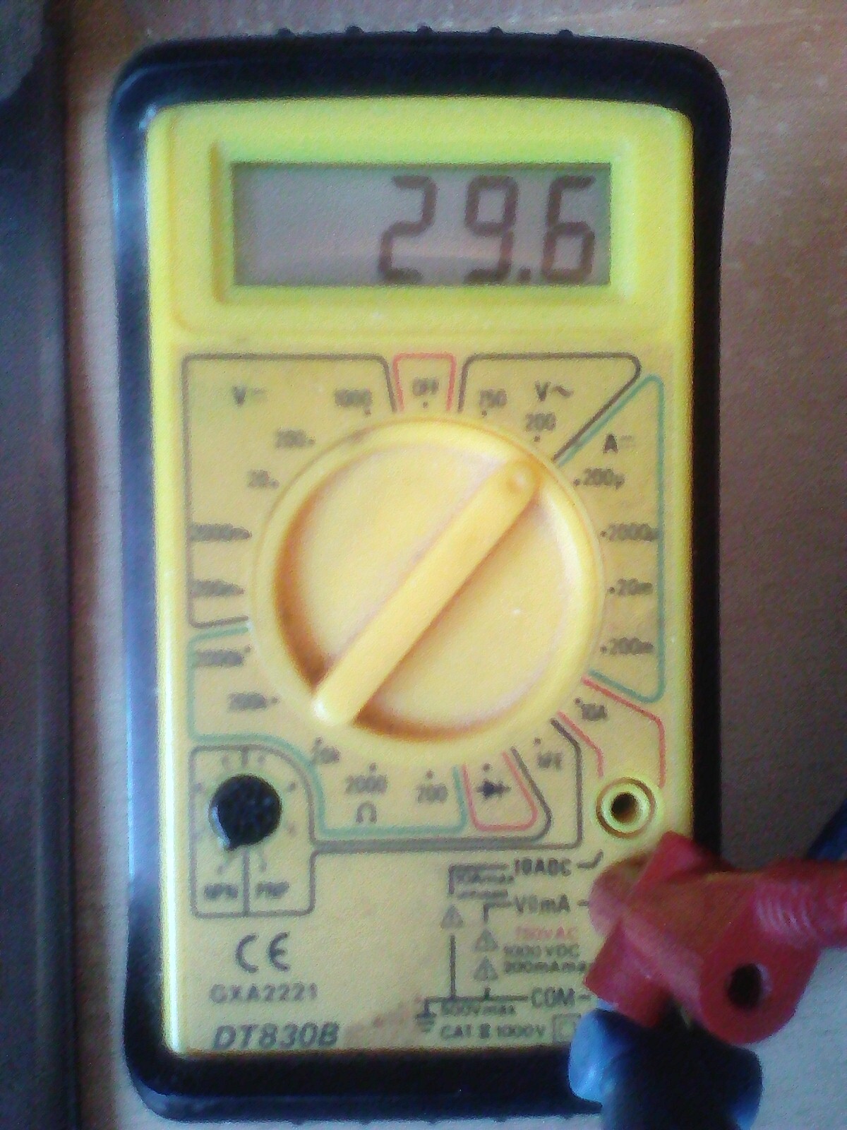

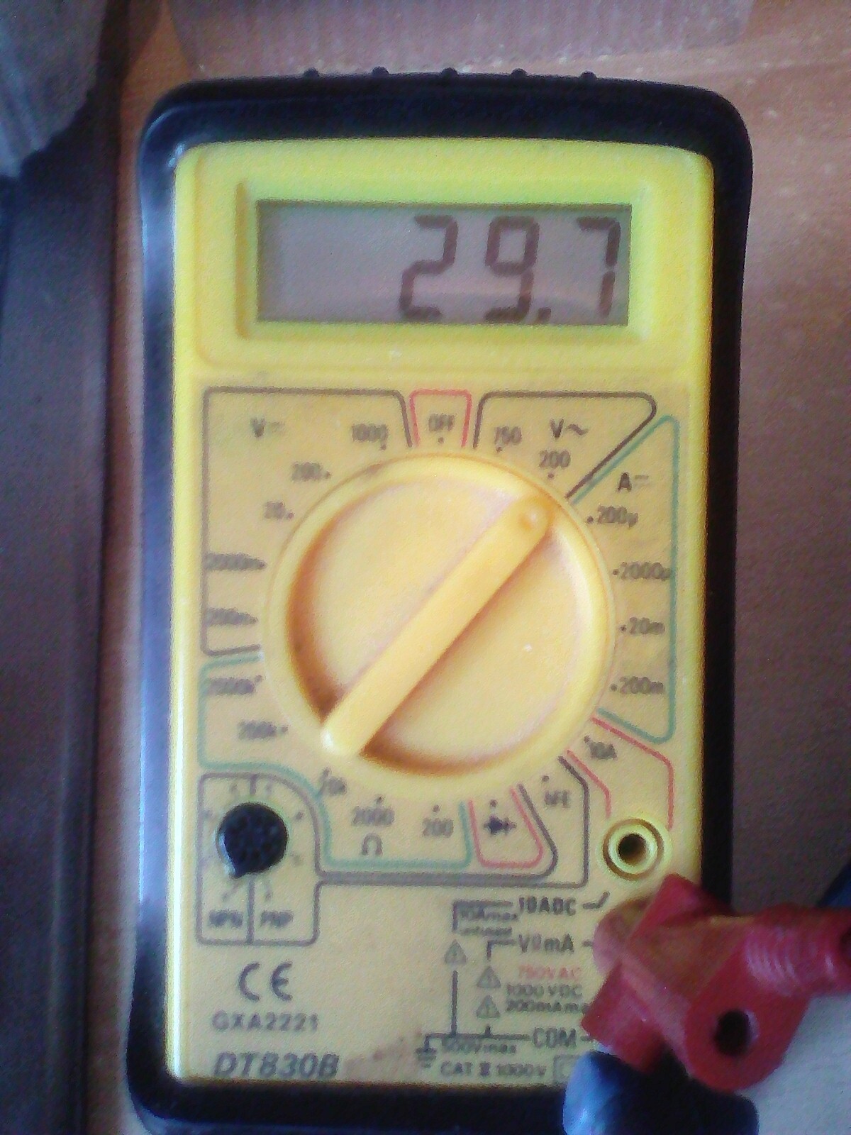

So, I have now measured the 2 voltages on the secondary side (see pictures)
Spannung 1
Spannung 2
This leads to the conclusion that the toroidal transformer is OK.
