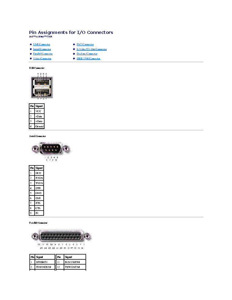

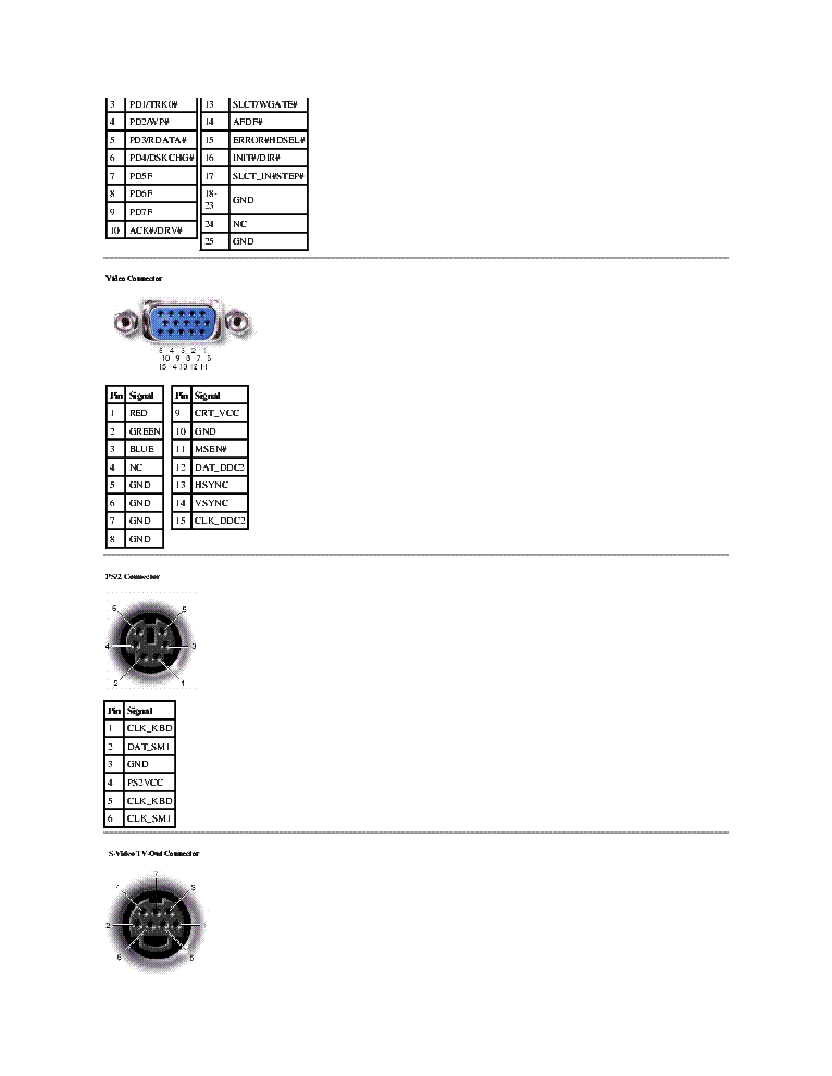

DELL LATITUDE C810 PIN ASSIGNMENTS EN
NOTEBOOK-PC - SERVICE MANUAL
177.4 KB
4
NOTEBOOK-PC
DELL LATITUDE C810 PIN ASSIGNMENTS EN service manual (1st page)
Preview of DELL LATITUDE C810 PIN ASSIGNMENTS EN [1st page]
DELL LATITUDE C810 PIN ASSIGNMENTS EN service manual (2nd page)
Preview of DELL LATITUDE C810 PIN ASSIGNMENTS EN [2nd page]
    DELL LATITUDE C-810 EN C810 PIN 810
